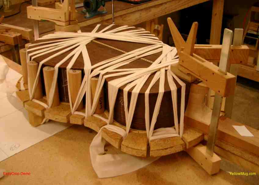

JP,
I use the roping method and dont have too many problems. I use 2" wide
bias binding tape bought from my local sewing shop or macrame rope
bought from same shop.
The important thing is to do a dry run and make sure everything is laid
out ready. Nothing worse than ending up a rats nest because you
remembered something at the last minute. Also, looking from above the
rope should have a radial pattern centred on each bout when youve
finished roping up. See attached pic of a back rope up on a classical.

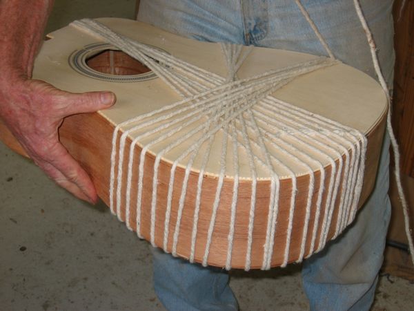

PostPosted: Sat Jul 01, 2006 9:05 pm
I really like the way Martin has the jig laid out for the roping method...that's cool. But given a few dry runs (and you practice with any old yardsale type guitar) and it becomes more do-able. I didn't use the rope method for the back and top (used a workboard instead, which I thought was great). We did use the rope method however as a supplement for the binding/purfling. Here's a shot of the example I took so I could remember how to do it. It's using a very long roll of "thick cotton mop string". There is no doubt it works GREAT once you get the process down.
